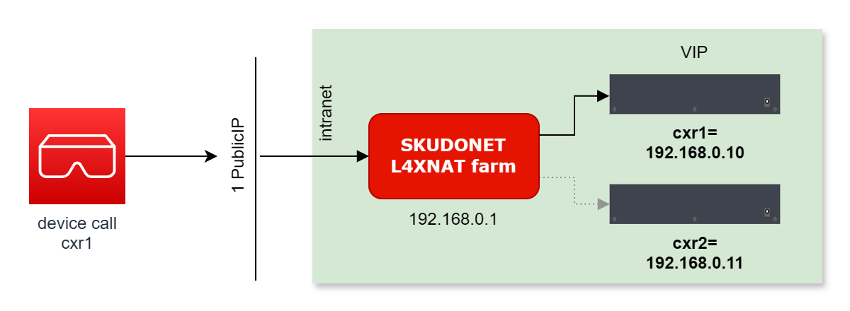

(@alanmartin)
Member Admin
Joined: 2 years ago
Posts: 14
Topic starter
it's Something like in the image attached correct?
ReplyQuote
emiliocm
(@emiliocm)
SKUDONET Engineer Moderator
Joined: 2 years ago
Posts: 64
Hi @mentalrey, That is correct. You reserve a Virual IP per cxr service.
I hope this configuration fits your requirements
ReplyQuote
